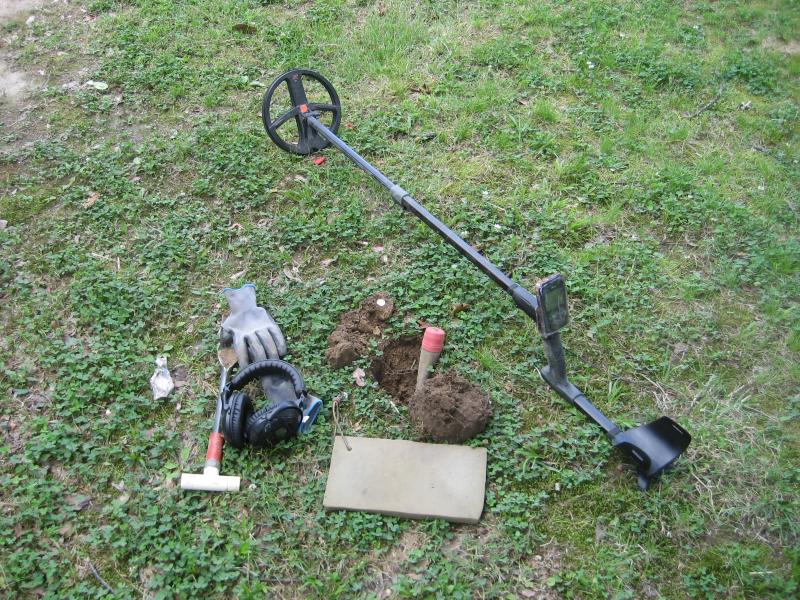

mein usa freund sucht meist in vorgärten und an strasseninseln also zwischen strasse und gehweg und benutzt ne kleine spule.( siehe FOTO ).da dort viel fussgängerverkehr über jahre herschte findet er auch viele münzen.mit ner grossen doppel-D spule wäre sein recover speed von signal zu signal nicht gross genug um silber zwischen den nägeln zu finden.

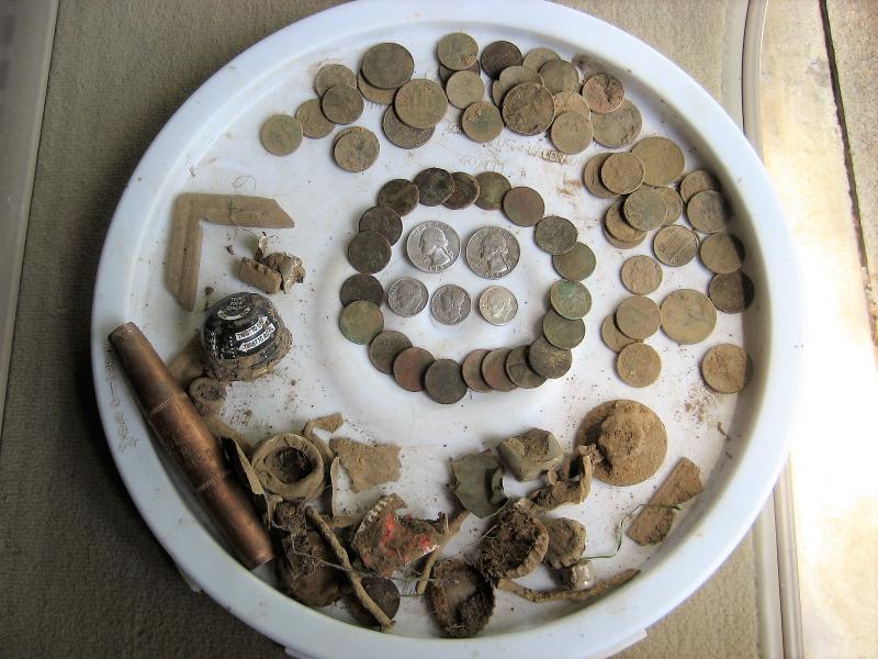

XP Deus - I Unearthed Some Nice Squeakers Today
( Here are the settings that I used: Discrimination -6.4, Full Tones, Sens 95, TX Power 2, Frequency 11.7, Reactivity 2.5, Silencer -1, Audio Response 4, GB - Tracking, Notch 0, Graphic XY and Norm OFF. )
I didn't feel much like going detecting today because I did so much digging yesterday, but I saw a bunch of rain headed my way and wanted to make hay while the Sun is still shining. I can always catch up on my rest when it's raining.
I headed back to one of the permissions that I got yesterday to see if could find some more silver coins. I pulled out my Deus and used the settings that used on the last hunt except that I lowered the sensitivity from 95 to 90.
The front yard wasn't all that big and a huge oak tree took up much of it. My second dig turned out to be a 1944 Mercury dime. That made me happy because I knew that I wasn't going to get skunked. That has actually happened to me before.
The next silver coin I found was a 1944 Washington quarter. It was close to the shrub bed and gave a sweet squeaky high pitched audio response and a ID number of 93. It was no doubt in my mind that I had a silver quarter under the search coil, so I cut the plug a little larger so not to hit it with my digger.
I almost didn't finishing digging the 3rd silver coin, because it was dead center under a huge tree root. From the audio tone and number ID I was pretty certain that is a silver dime, so I decided to dig down one side of the root and see if I could get to it that way. Finally, after a lot of hard work, I recovered a 1937 Mercury dime.
The 4th silver coin, a 1945 Mercury dime, I missed when I went over that area the first time, but hit it the second time when I swung at it at a different angle. It turns out that iron was masking it from one side. That got me to thinking that I might want to give the factory 'fast' setting a try.
The fast setting did its trick and found me a 1957 Rosie dime right next to some iron. I like its performance, but I don't care much for the audio. I'm going to have to come up with a custom fast program that I like. It will have to be one with full tones, because full tones is the only way to go.
